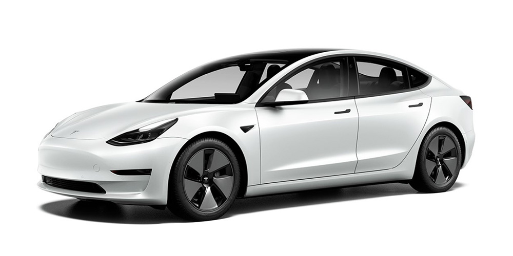

    For the same price range can be: ID3/ID4 (maybe with the same issues), Renault Megane E-tech (EV60) or Tesla Model 3 (they are quite cheap now)
